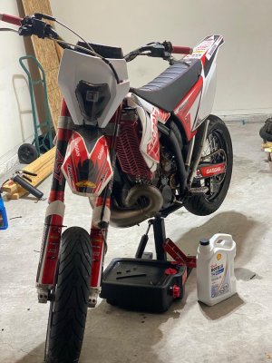

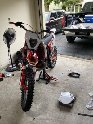

warp9s came in. got them wrapped. 120 front 160 rear.
needed to make a new spacer for the front axle to avoid having the wheel offset
rear spacer needed to be shaved slightly to fit with caliper bracket. should be wrapped up with DC conversion and light kit this weekend.
