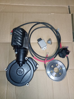

Hi Everyone, I'm wondering if the electric start components for 2014-2020 gasgas EC300 will fit on a 2012 EC300?
Not having the two bikes side by side I can't confirm the engine is the same, but my understanding is it is the
same minus porting.
I would really like to add an electric start to my bike.
Thanks!
Kevin
I know you should be able to add any e-start from the '11-'13 bikes but not sure about the '18+ setup. I installed a '13 e-start on my '11 EC250 and love it.
NOTE: Edited my post to eliminate the incorrect info.
Thanks for commenting, I was just told by Mark Berg of CPD-USA that the 2014 cases were different on the magneto side and therefor the kit for them wouldn't work on my 2012.
I would love if this wasn't correct or if some small mod needed to be done to make it work however as the 2014 parts are available!
2011-2013 Were the same.
Honestly, I didn't know there was any case difference but if Mark says it then I believe it. Sorry for the misinformation.
