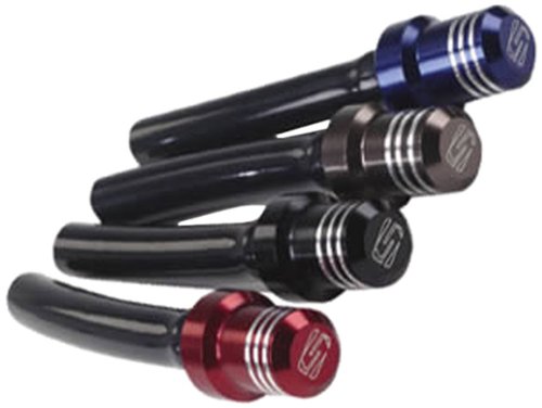

where do you get a check valve for the vent hose? Before i went the DIY viton route i tried to find a vent hose check valve (not the shorties - i have heard too many stories of those blocking and not venting)?
I have this one on the Clarke tank and so far works great. The check valve has never been a problem and it actually keeps the gasoline from dripping when the bike is upside down. Tested and proven :D:D
Sunline 31-06-001 Aluminum Gas Stop Valve
Go to your local Yamaha dealer and order part no. 3XJ-24380-00-00 (PIPE JOINT ASSY). Oddly named, but it is an inline vent tube. Item no. 4 on this schematic: http://www.partzilla.com/parts/search/Yamaha/Motorcycle/2011/YZ+450F+-+YZ450FAB/FUEL+TANK/parts.html
