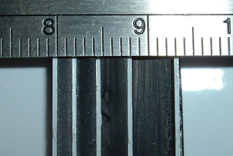

I've been using the Michelin Airstop HD tubes for a couple of years and have no complaints. From left to right: OEM, Michelin, Moose Supertube, Bridgestone UD.
