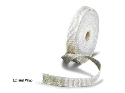

Just curious... I've seen the header wrap tape used on 4T bikes to get a better internal chamber temperature (and less accidental burns to yourself). Could this be used on the 2T bikes to provide some sound absorption?
It would also serve to maintain pipe temperatures which in-turn influence internal pressure. Of course, the 2T pipe shape does not lend itself to easily wrap it with tape. I've been curious about the idea for a while. The cost of the tape is holding me back from trying it (about $50).
Here is some from Helix to give you an idea (50in x 1in). There is also a 2in width.

I actually have a pack of exhaust wrap from DEI that I was going to use at the last race for just incase I didn't pass. It's a 2"X50" roll. I haven't put it on yet because my pipe needed some dents removed. :o
I'll give a report once I put it on and see if I can borrow a sound meter.

UPDATE! We wrapped the pipe last night with header wrap and it made a HUGE difference. The tone is a lot lower and just quieter in general. Going riding this weekend, I'll let you know if the pipe blows up.
Note: Wraping the pipe was very time consuming and fustrating. Material used: Design Engineering Inc. 2"X50" wrap and 10 SS ties
