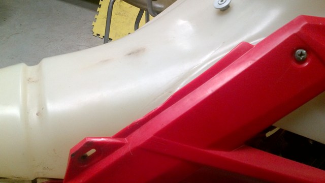

Here's some:
You will have to find a solution for the side covers

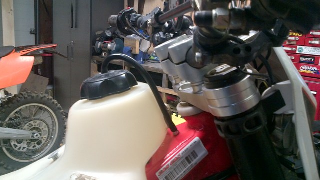

Detail of the piece that keeps the tank from moving up
The general fitting of my tank is not really bad except for the side covers but no big deal.

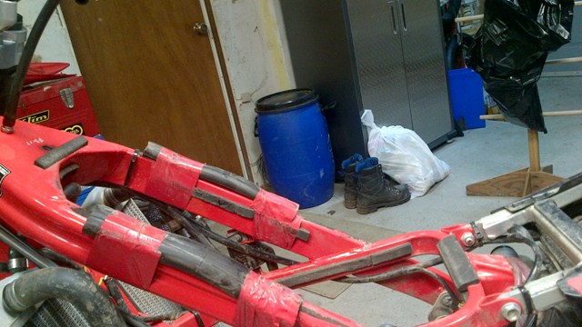

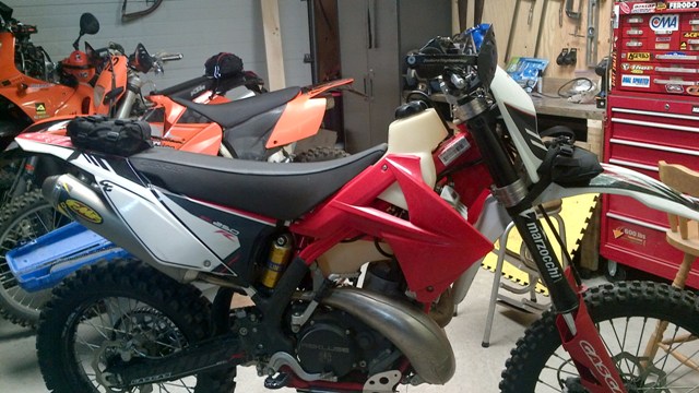

Here's a couple more pics. I had to add some spacers under my tank as it was hitting the throttle cable and the rad hose coming out of the head.. was starting to wear through the tank!!! I don't have a steering damper but it looks as if there is enough room.. I also did some trimming of the rad shrouds to get them to tuck in a little closer and to minimize wear on the seat.. doesn't fit perfect but it does fit...
