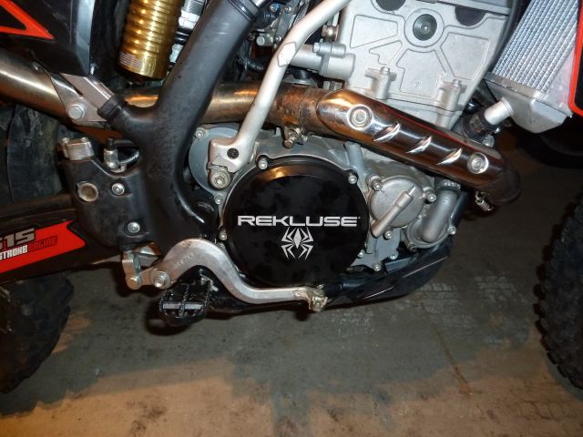

Put on my Rekluse today. Great success, no more stalling, fast cornering, full concentrating on riding in up- and downhills not concentrating on handling the clutch. I?m happy. Ingredible starts in 3.gear with following wheelies, great, great. Greetings from Germany Thomas
