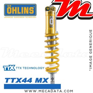

Hello does antene know sag if this rear shock.Gg ec 300 201.And best setup i have 100kg.
Any guide to setting sag will be the same procedure for this shock.
Now, if you're talking about the measurement for what it should be on your bike, 35 mm +/- 5mm for static and 105 +/- 5 mm race sag is the numbers the 2015 manual says. I think, by your username, you have a 2014 which is the same chassis so the numbers should be correct.
