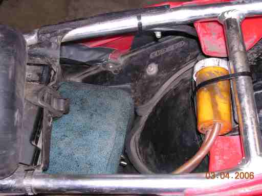

For the vents routed to the airbox, I used a small medicine container. You could use a 35mm film container too. Just put a hole in the bottom and route your vent tubes into the container. I put some pillow stuffing inside the bottle to filter, but some foam would do the same. Then, I put the cap on which had a hole in it so it could breathe.
Here is a pic of mine installed.
