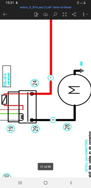

Skullanova New member May 12, 2026 #2 I think that wire goes to the starter motor. So wire 1 comes from battery and if start switch is closed it energizes the coil. Once coil is energized this closes the contact between 1 and 3 sending power to starter motor to start up bike.
