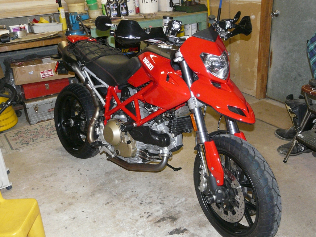

I got my lights today, free 2 day from CA to NJ, amazing service. They are very high quality and very small, easy to mount. For the Hypermotard, I have swapped the OEM plastic handguards for Ducati (Acerbis Rally Pro) metal handguards. A simple 1" section of 3/4" angle aluminum on the inner handguard bolt will provide a perfect mount. They will sit in front of the brake and clutch resevoirs and lok great. I'll post a pic when done in a week or so, after I get a heater for my garage.

I got the VisionX lights on the Hyper. Still waiting for a rocker switch to wire them up but they look awesome mounted.
Uploaded some pics to my album, check them out.
Thanks. I can afford to remove some material from the brackets, and throw them in the next batch of parts that goes out for black powder coat here at work. I still have to aim them properly, but judging by how they look the headlight will not matter much.
