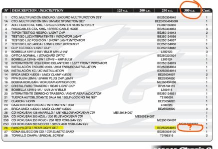

But the rear brake light is the challenge, and looking thru the parts list from this site for the 2004 model, I see NO parts for the brake switch anywhere. Assuming there is power somewhere in the disconnected harness that is zip-tied up under the seat and front rad shroud(s), is there an aftermarket pressure-switch I can adapt, or a factory GG switch from a later year that will work? The existing rear light has a factory 3-prong connector, ground, running light, brake light.

ALSO: Kind of un-related to the posting title, but can anyone suggest an alternate to the factory BE250234015 rear light assy? Parts list has EC300 application for a rear license holder, but NO effectivity for the light....and that light P/N does not show up in any on-line searches:

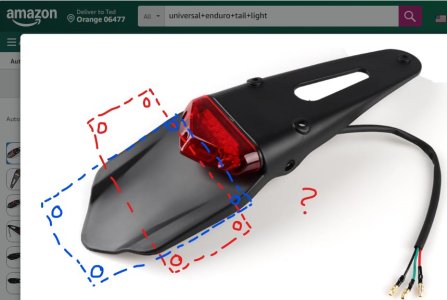

So, here is a similar item on Amazon (of course) for dirt-cheap, which is my kinda price. But a general question:
How do people mount a standard US-issue motorcycle plate on any of these mounts, where none of them seem to have the surface area or shape to accept a plate, no matter how you try to mount it? (red or blue):
