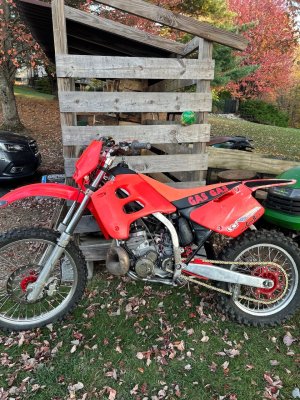

Finally got the old gasgas going…Counterbalancer is a game changer, so far after a few laps getting the carb dialed in it’s much better than my 06 ec300. I got some kybs from a yz450 that are gonna be replacing the old marzocchi’s

It did not have the counter balancer from factory…only had the balance weight under the crankshaft pinion gear. It had the two seats for the CB bearings but they weren’t bored to the correct size for the 6203 bearings. I did the “machine” work myself with sandpaper and a drill press. Sourced the counterbalance shaft and drive gears on eBay.
Did you install a seal on the left side ? My wild quad 300 engines have balance shafts . Not long ago I bought a set of 1998 250 cases for balance shaft . And about month ago drive couple hours and bought a complete balance shaft 250 engine and most of rest of bike . I have to build another balance shaft 300 to install on second wild 300 I have that was reverse model with bad ignition . Not ignition parts for this one anywhere .
I did install the balance shaft seal…that first photo I posted of it was just a mock up when I got the bearings in. I think I remember seeing a 98 ec250 in engine on eBay for like 600 bucks which isn’t that bad of deal knowing how good these old counterbalanced engines are. What ignition is on the reverse wild engine? There was somebody parting out a reverse wild engine in Maryland on fb marketplace last year or so.
