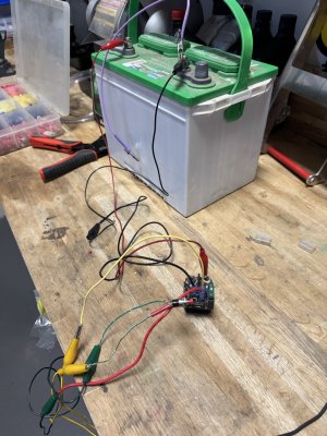

I figured out the issue this weekend, just posting in case it helps someone. I took the starter solenoid off and bench tested it. I put my set up in the pictures but essentially I just put the black wire to ground on the car battery, and then wired the red and yellow wires to a momentary switch similar to the starter switch. The red alligator clip went to the positive side of the battery. When I pressed the switch I heard the click of the solenoid magnet and also took a ohm measurement across the two main posts. So the solenoid was fine. The problem turned out to be that the starter button on the handlebar switch wasn't working. Once I cleaned up the contacts on the switch with contact cleaner and put it all back together the e-start worked again. Also, I learned that there doesn't actually need to be12v coming from the handlebar starter switch, the switch just needs to complete the circuit to ground to get the solenoid to trigger.

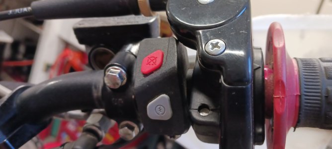

Good work. Lots of things you are just connecting to ground to complete the circuit. 12v will be delivered to the item.
Contacts are usually brass and to tarnish after time but terrible environment on a dirtbike. Aftermarket single waterproofed switches are better than road based multi clusters bikes come with depending on market I guess.
I think we did that mod on a mates GG as soon as he got it so kill and start were dedicated dirtbike switches.
If your using the multi-function switch it's prone to failure and very expensive. I took mine off and used the simple start button off the XC.
I had a similar issue w/ my 2018.
The switch has sealed contacts. Had it apart 3 or 4 times. Seemed like the switch had silicone grease inside the sealed contacts......when I pressed it numerous times, it squeezed out some substance that looked like the silicone grease.
After intermittent works/doesn't work issues on the trail & multiple times cleaning it, I gave up & installed a KTM on/off switch on the right side handlebar.
I left the multifunction switch in place.
