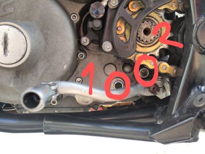

I fill it to the top of higher one at least, usually even more. My bikes have oil pressure sensors and not having enough oil causes them to come on at when bike is leaned to side or when doing a rapid acceleration. I can not tell you for sure that this method is correct but I have been using it with 2 GasGas 450s(same engine as you) with success.
