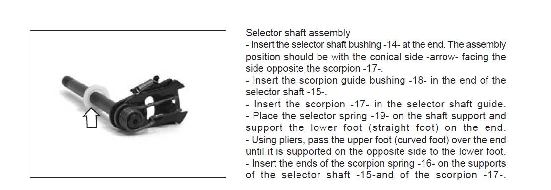

After days of confusion the selector axis is just another name for the shift shaft. According to GoFasters the white washer goes on the shift shaft before installing in the case, does this sound correct? I threw away my bent one without looking at it closely. The GasGas fiches are incorrect in several ways and cannot be trusted. There is no internal piece as shown in some years of the parts fiche, that is incorrect. Am I the only one who ever bent a
shift shaft? Is there a correct diagram of the shifter side somewhere? By the time I get the correct parts I'll have a hard time, should have taken pictures.

here ya go. there's nothing floating around in there. white bushing keeps selector shaft from moving in and out - without it i would assume the selector(scorpion) could bind
