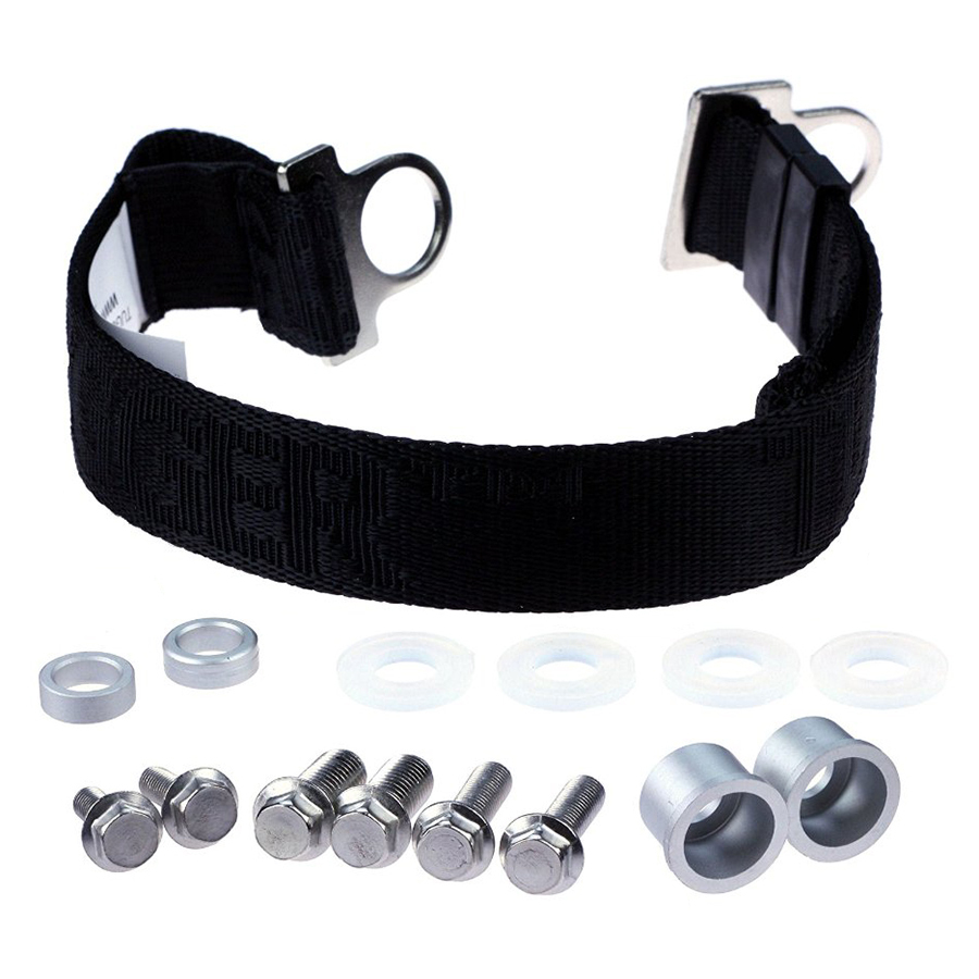

I have a 2010 EC 300 and my strap attaches to the bolts that attach the plastic part that holds the tail light to the subframe. On my bike it's the plastic part known as the tuition support or the racing tuition support. It incorporates the tail light and the number plate holder. There are 2 screws on the back which attaches it to the rear guard and 2 screws or bolts on the front that attach it to the subframe. These 2 screws at the front is where the strap attaches to so that you are effectively lifting the bike by the aluminium subframe. Hope this helps a bit.
This is the strap that I have, a Tugger Strap. The 2 sleeves or bushes at the bottom right of the picture fit through the rings at each end of the strap and then push up into a recess in the plastic tuition support. Then a bolt goes up through the sleeves or bushes and attaches the strap and the plastic tuition support to the subframe.

Philm, nice pictures. Thank you! The 2013 body it is a little different. I will figure out how to attach. But will follow your idea. Thank you my friend! Btw, nice bike!
