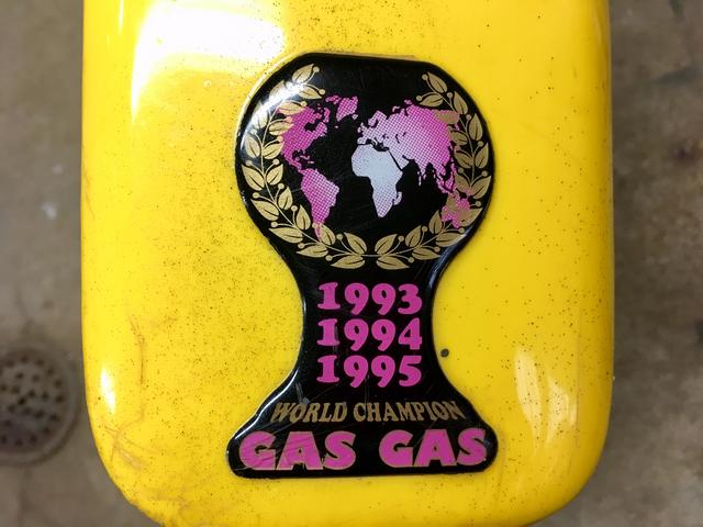

This is embedded into the tail section on my bike. Apparently, Gas Gas has seen some hard times. The shuttered factory in Spain was only recently reopened under new ownership. Let's hope it can find its way back.
