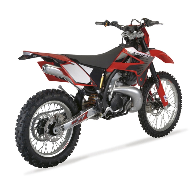

This is the stock silencer that comes on the Euro bikes and also on some of the Canadian models as well. Have some ideas and would like to find a takeoff or one in decent shape.
Looks like it's the same silencer from 2003-present.
Here is a pic. Has the elbow in it.
Well first I want to see how it compares sound wise to the silencer that came with my bike (just a long straight sliencer with no S/A but not terrible) and my quiet 97 KTM. There must be a reason this bigger silencer is used everywhere else but in the US market and I assume it's a quietier sound and I love a quiet bike. Second I believe I can adapt a Kritzman internal S/A from an old KTM hockey stick silencer to this one with a little work (personally I think the whole S/A thing being needed on 2 strokes is total BS. On a 4 stroke yes). Love a project. Yeah, I'm aware of the FMF TCII and I'll also have a Db Snorkle to mess around with. What I really want is FMF to build the new Stealth silencer for the Gas Gas bikes but I guess we will have to wait on that. I also just like the looks of the silencer better than the little shorty ones. Silly but that's me:rolleyes:

The stock Euro (Messico, non-S/A) silencer, that came on my '98 EC250, was by far the quietest, non-modified silencer I've ever had on a GG. It killed me to hack 6" off it to attach a USFS-legal S/A. Before adding the S/A it tested in the high-80s. After adding the S/A it gained ~4 dbA.

'07 has a different bend in the pipe that connects to the stinger, because the subframe is new. All the '07s I've seen come here came with a Messico silencer only, no SA. Its shorter, barely protrudes past the right rear side panel.
The euro one pictured has the same part # from 07 back to 03 at least.

Boomhauer, you probably have the shorty silencer that comes on the racing edition bikes. I have one of these and it's great (still quiet - tested around 88dBA with old packing, haven't tried with new stuff yet) but lacks a spark arrestor.
From what I've seen its different. Even FMF had to make a new TC2 for '07+. I've seen pre '07 silencers heated and bent to fit the '07s when they first came out. If you really need the big GG silencer/SA then I'd make Steve an offer.
