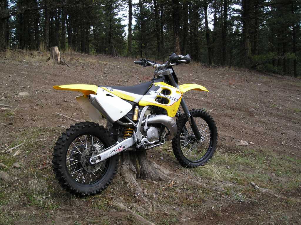

the seat i have spare is this one. it's very narrow along the top ridge, and almost straight across the ridge. i don't like it - harder to load the front forks in turns...i like the seats with a dip in the front - easier to get forward/low.. i don't know if 04 seat is same as 03 seat.
http://www.gasgasrider.org/gallery/data//500/medium/july_07_050.jpg
Thats widebear's bike, you can ask him but it looks like a tall foam with the OEM cover. Angles can be deceiving though. I don't like or need tall foam either.
