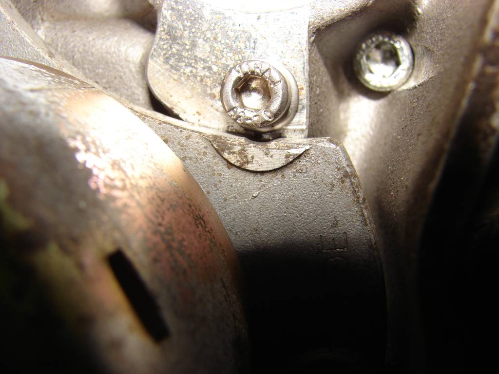

Greg,
If you get a chance could you snap a picture of the location of your ignition. I have never really been quite sure that I have it timed correctly.
Thanks
Jason
first pic shows location of m5 screw/washer. plate in pic is advanced 1mm from washer.. it has really improved performance....if plate rests against washer that is stock timing via GMP method. the right way is with a dial indicator of course, but i'm lazy.
P.S. PLAY WITH TIMING AT YOUR OWN RISK. IF IT'S PINGING IT WILL PROBABLY NOT LAST LONG...........i blew up a rd400f getting a bit too advance happy.. but it ran amazing for about 2 miles before piston meltdown.... if plug shows any signs of metal dusting you're way too far advanced.. if it heat siezes, then releases, it's detonating and destroying the front side of your piston....................
Well crap, that pic explains alot. I just finished putting a new topend in my bike because the ex. side of the ring was absent. I had my timing set with the m5 screw but was using a larger m5 washer, I probably had 2 more mm. of timinig than you. It lasted almost two yrs., but I ran 100 octane which might have slowed its death. Thanks alot for the pics you just saved me 200.00 more.
Jason
if you weren't running 100 octane you would have melted the whole exhaust side of your piston relatively quickly. i'm assuming it chunked the ring and the ring land on the exhaust side?
o.d. of washer i am using is 10mm
Oddly enough the piston looked good, the ring however was ground down to nothing (1/4" end gap). I had just assumed that I had ran dirt through the thing since I had a filter that had started to come apart at the seams. I rarely ever run on the pipe mostly tighter low speed stuff that may have also saved me.

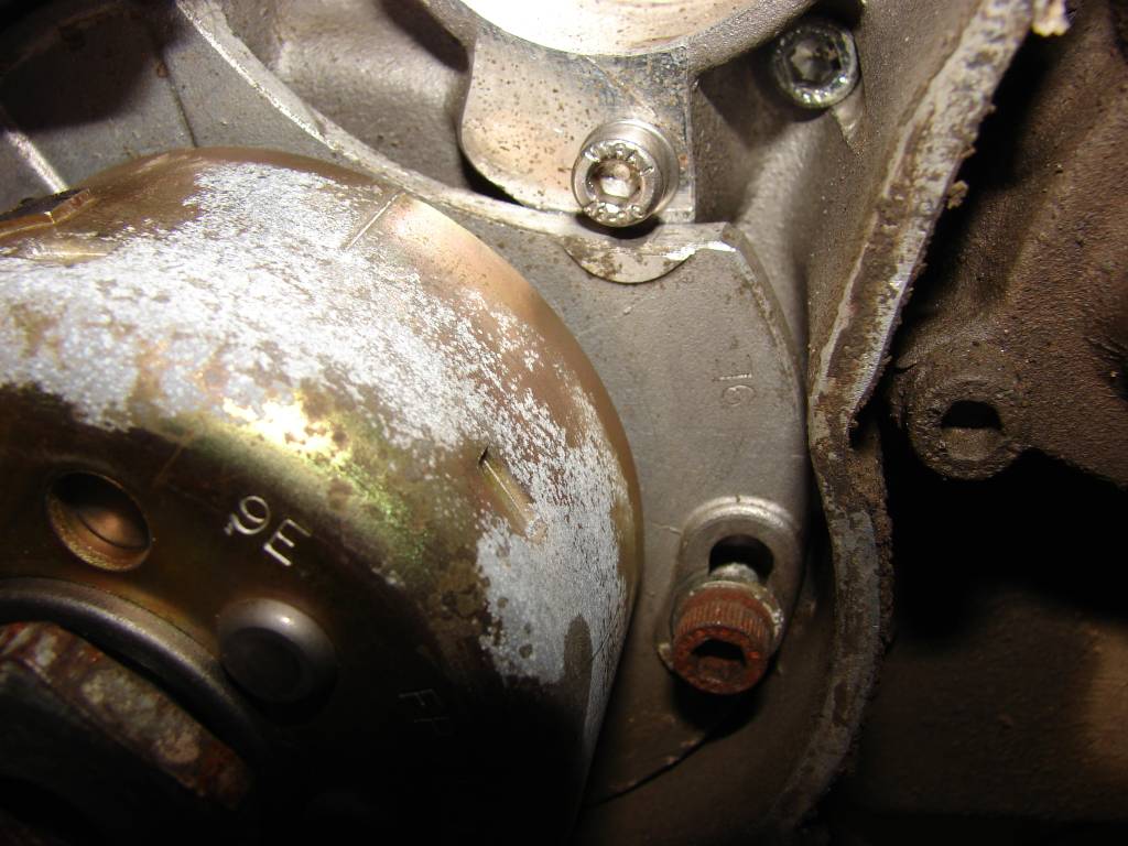

this is where mine is at right now, if i set it at STD position,it wouldn't idle as it should :confused: as if there was hardly any compression.
i tried even more clockwise (allmost fully clockwise) and the power was amazing, instant power,no hessitation from idle at all!! :eek:
but there seemed to be some sort of 'strange' noise from the airbox (so it sounded) but not well noticeable.
so set it back to where it is now an still have yet to test it at WOT.
seems like it's set at halfway the slots.
any thoughts about this?
i ride 95-98 octane fuel + 50:1 oil.
any thoughts on my timiong setting, how much more can i go clockwise?
can it be measured in the slots?, like halfway or even more?
where you're at is about the most i'd advance it and feel comfortable. if it makes any kinda funny noises, when hot and at wot, back it off a bit. if it's really hard to start, you're too far advanced also...
