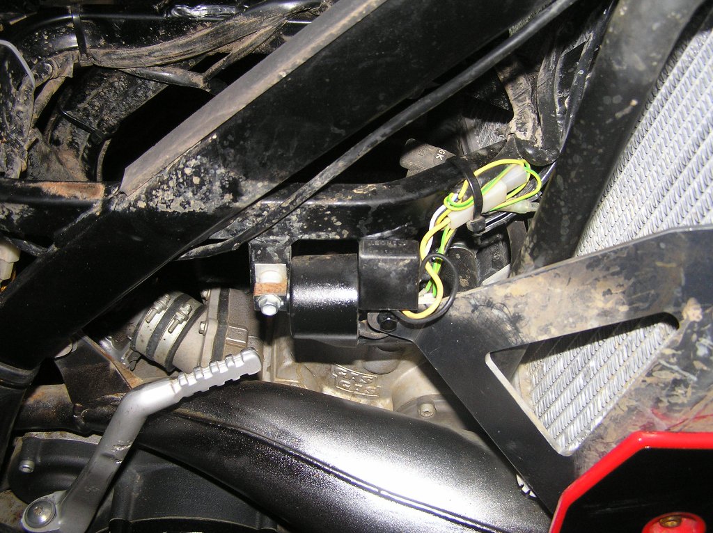

Does this apply to the 07 models as I can’t seem to find a blanked off yellow wire under my seat. I fact there are no yellow wires under the seat at all. The only yellow wire on my bike comes from the ignition? (On the right side of the frame behind the radiator). If anyone has any ideas I would be interested in hooking this up. If I can’t then I guess its no big loss but would be interesting to know your max revs.
Thanks
Kerry
I wonder if my bike is slightly different from standard. It was used for the ISDE in NZ late last year. It was brought in specially for the ISDE. It is missing anything to do with the road kit, but I wouldn't have thought the tacho would be associated with that. I'll post some pictures at some stage and show you what I mean.
Thanks
This is the only yellow wire on my bike that I have found.
