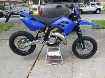

I have a whole kit I attempted to graft onto my 05 EC125.
I bought it from GreensomethingMX in Spain.
It didn't work out for me, and I would be happy to part with it. The only damage done was some greasy fingerprints on one of the lower fork guards.
Subframe, seat, all plastics, head and taillights, graphics.
I think all the parts are for a 2012 EC250.

What went wrong?
To be honest, it just didn't fit.
Maybe if I had another bike to go look at I could have gotten it to work, but when I had the bike apart I cleaned it up and removed the graphics. Decided that it looked good enough.
