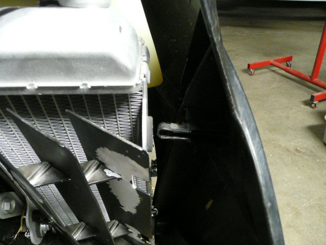

For the shrouds, add an LTR GP brace through the top mount grommets. Now get a vibration isolator used on the lower pipe mount. Thread the M6 stud into the LTR brace. Now, cut the tit off the shroud and drill an M6 clearance hole to mathh the hole in the isolator. Use a 10mm M6 bolt and fender washer to retain the shroud. You may have to add washers behind the isolator to adjust fit.
You can also attach the isolator to other rad guards/braces for the same result.
I've been doing this on my last two bikes with the stock tank and it makes the shrouds much more durable and less likely to be torn off up top. The isolator will flex and not crack the shroud in minor impacts.
Glenn,
Do you have a pic of your setup. Sounds interesting?
A quick approach would be to drill through side of the nipple. Then, run a zip-tie through nipple and mounting hole.
OR: push the side-drilled nipple through the mounting hole and put a R-clip or cotter pin through the nipple. This may help keep the shrouds closer to the bike too.
Another plus of this is that if the shroud is pulled hard it won't stretch the top of the rad out like an accordian, or break off the mount. All the force is to the frame through the brace. You don't need to buy the GasGas part for the isolator. Mcmaster has the same thing and in different lengths, they are industry std. parts. You can use different lengths and washers to gain clearance for the big tank and/or rad guards. What works and looks good for the bolt is the M6 aluminum helmet visor screws you get extras of with HJC helmets. I'll find and post part# later.
