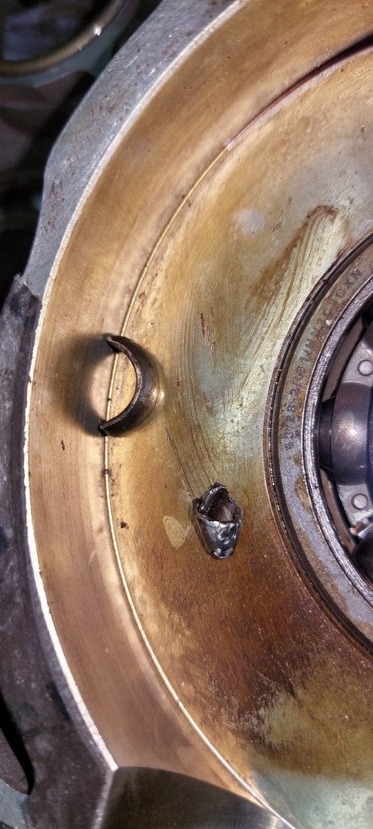

Long story short, I swapped out the piston and main bearings at around 600 hours and within 4-5 hours the right side bearing cage failed. Luckily it wasn't in the field, I had just washed the bike and was tooling around to let it dry completely until a loud screeching started and I shut it down.
(the orange stuff is silicone - I usually smear a bit around the crank seals just as a precaution for case/ seal imperfections. It looks like a lot, but it really is just a smudge)
The damage on the cases wasn't too severe. The inside was fine (god knows how) and the outside is a bit scored, but nothing too serious.

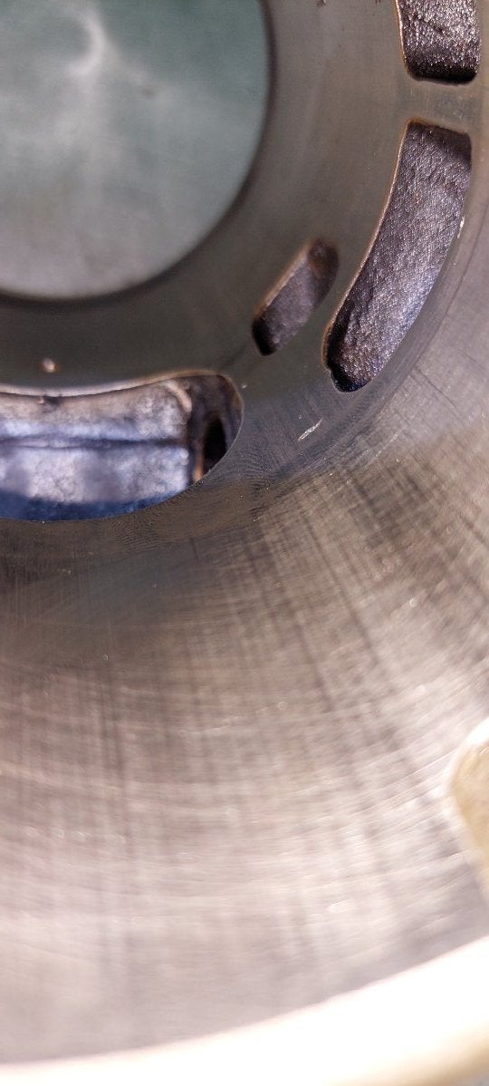

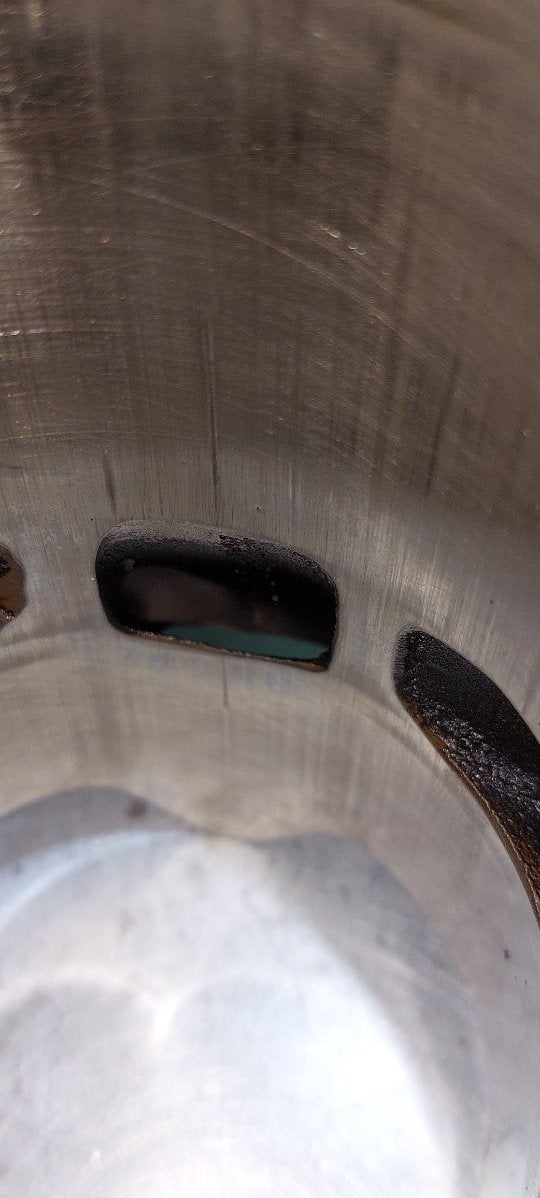

The main problem right now is the cylinder. Somehow a chunk of the bearing cage made it up to the cylinder and left some marks:
This was a real kick in the dic...wallet, since the cylinder was really fresh before this whole ordeal. The scratches aren't "too bad". I can kind of feel them, but they don't go all the way through the plating. The chip however is a real bastard.

Sorry, hard to tell from pictures. Chip? Is that the mark by the transfer in pic 1?
The question is, will the ring pick up on it and can you really see aluminum through there? Or am I missing seeing something?
The piston is moving real slow near the ends. The compression doesn't build until the exhaust port closes of course.
A hone with proper plated bore hone may tidy it up.
All cylinder replating places will have the equipment. They can assess he damage at the time.

Yep, that spot is chipped all the way to the aluminium. The scratches aren't quite as bad, but you can definitely feel them with a nail. Keep in mind that these pictures were taken after a clean and a stone hone, so it won't get better than it is.
