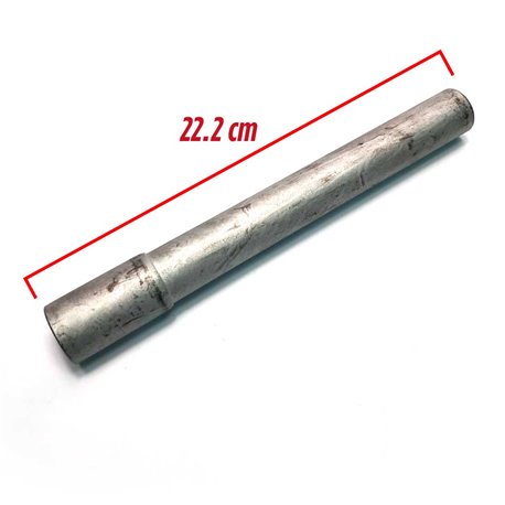

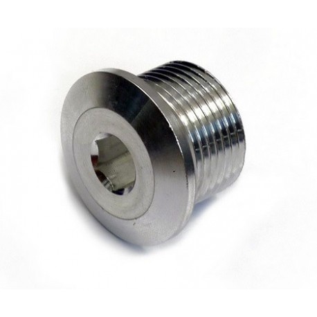

They have it at Motocrosscenter in Spain:
Axle:
The nut:

Just to be sure:
  • does your axle and nut look like the ones in the links from Motocrosscenter (in my post above) ?
  • Is the axle of the same length (22.2cm)?
  • is it 25mm diameter on the long part?
  • Are the threads in the axle OK?
If so, I cannot understand why it should not fit, if it did fit before you took it apart.
My axle nut is the one that you sent me in the link .
Yes the axle is the same lenght
And yes it is 25mm diameter
No some threads in the axle are broken like the first 3 have small holes 🕳️ in them like potholes
Sounds like crossthreading to me. If you are able to clean those threads (e.g. using a thread file) I guess it will be OK again.
