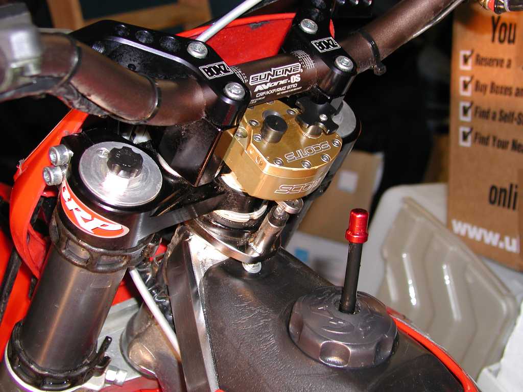

The Hottest Ergo Setup
I've spent tons of time figuring this out!
I'm 6'1" and 195lbs and ride a 2003 EC350
You want a BRP triple, it will move you forward, about an inch and up an inch.
Bar selection is also critical, I bought mine direct from Sunline, for some reason they discount their bars online to $50 which is about half of retail.
These bars are filled with elastomer, so it also acts as a dampener. And it comes with a trick pad. Jimmy Lewis gave it a good review.
You will also notice that I have a Scotts dampener, and I'm using the Cycra Pro bend bark busters with the Bonz bar clamps that allow me to connect direct to my bark busters.
The triple is also rubber mounted to the sub mount that also cuts down on vibration. I use super fat silicone grips from Progrip.
This setup is comfortable, allows me to stand for longer periods of time and cuts vibration down to zero.
I almost bought a flexx bar, but with this setup I don't need one.
Here's a pic of my ergos.
That is a nice setup.
It is difficult to actually see a full perspective from a picture. It is clear that you have moved the bars up.
Have you really moved the bars forward? The reference I use is the stock bar mount centerline is just above the top center of the fork adjuster knob. Your bar mount centerline does not appear to be forward of the fork adjuster knob. However, it is diffcult to tell from the picture.
