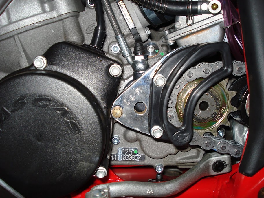

To me, looking to the carb. In ALL GasGas the carb is not aligned front to back.
In newer models, looks like there more angle. This can made the gasoline leak more???
Its angled forward to keep it level for all the time you spend on the back wheel :D
I noticed the same thing looking at mine, but even then I get great fuel efficiency.
