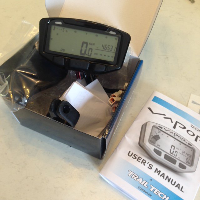

My 2010 EC200 has one of these factory computer things, it works (time, speed, temp), but none of the buttons do anything, so I can't change screens, adjust it from mph, time or adjust..anything.
Tried the reset button on the rear, and holding down all 3 main buttons for 3 secs (like the manual says), has new standby battery....... anyone got any bright ideas?
images
I have 2 of these on my dual sports. If the buttons don't work then you'll need a new one. They're cheap. Also if you contact them directly they can tell you how to program existing mileage into a new one
Took the Forums advice and emailed Trail Tech in the USA. Tbh I wasn't expecting much as I'm in NZ and my busted Vapor is 5 years old.
BUT...no issues!! Trail Tech were sorry it hadn't lasted as well as most usually do, and sold me a new Vapor at literally a fraction of the price of a new one and shipped it to me.
Trail Tech = Awesome service.
