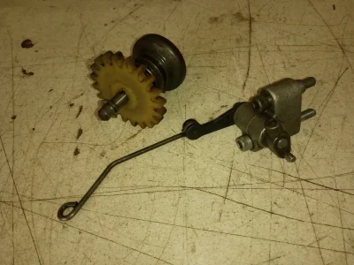

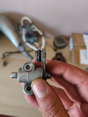

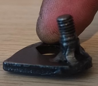

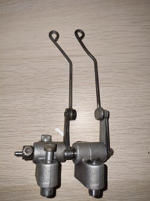

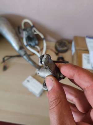

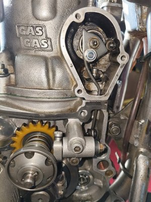

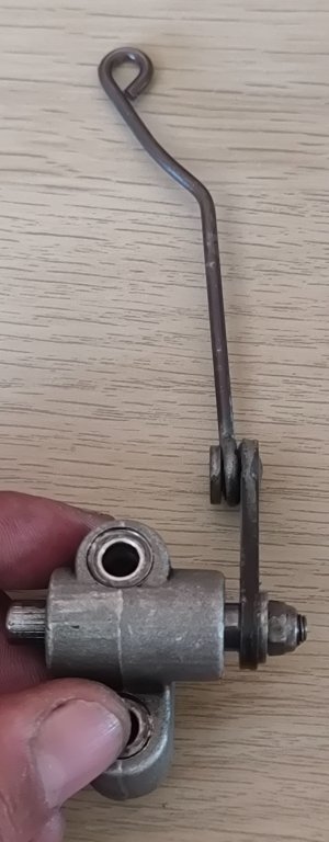

So while replacing the actuator part (came today old one in photo ) I noticed still not perfect done ABIT more research and the idiots have welded the arm on backwards so it's hitting the side of hole arm goes through found one online going to try pick it up this weekend.

You ordered the part that bolts in with two screws and had linkage rod ? Not the part with bubba welded stud on it ? I thought you ordered the welded repaired part ?
yes i ordered the new first picture and when fitting new one realised the second picture linkage arm was welded too so i checked online and its backwards
Yeah your issue like I said was power valve . And as mentioned some previous owner did something wrong and you now have to figure out what .
