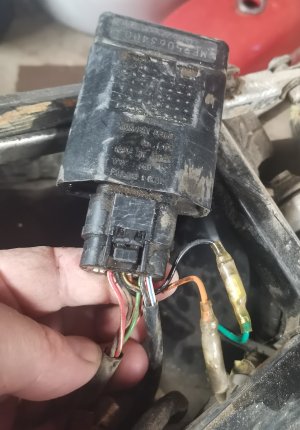

This is from my 06 EC200. The map switch makes or brakes the contact between the orange and black wires with the bullet connectors to the right in the picture.

I bought the bike without mapswitch and installed the switch at a later stage. I'm not sure, but I think connecting the black and orange gives you the "sun" map while an open circuit give the "rain" map. It's easy enough to test, just connect, ride, disconnect, ride. I presume you will be able to tell the difference. The map switch can be any switch that connects the wires. It does not have to be the one on the handlebar (or as I have it, on a radiator hose).

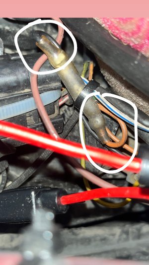

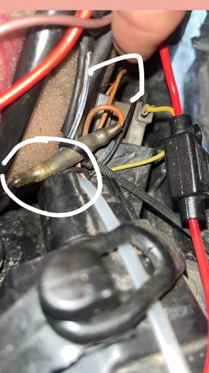

I will take a closer look to see if they are wired and going somewhere and if they are im sending a pic to see where they lead to, thanks !

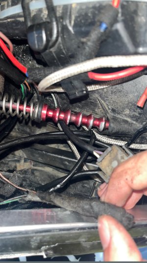

0AFDF5B3-A227-4891-B15B-0509F1B3D08E.jpegSoo the black wire comes from cdi and goes in that thing i dont know what that thing is what that socket is its wired the black wire from cdi tot that thing orange wire
And goes there to these somehow these arent attached to anything i dont know what they are

I will have to look at my own bike again to see if I see what you mean. It may take a few days.
