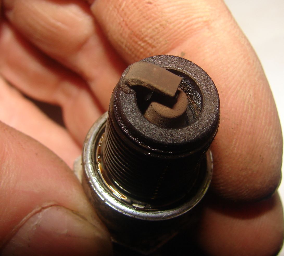

here's the plug - looks kinda nasty - i did swamp the bike for a few secs on sunday :)
kinda impossible to read probably because of it.. it looks rich, but sucking some water in the airbox probably permanently screwed up the plug for reading...

BTW that reddish brown plug looks typical of what I have seen on my bikes running leaded VP red or C12. Not neccessarily bad.
