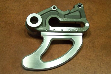

I have had some spare time at work lately so I decided to build my own Sharkfin and Hand guard mounts. What do you think?

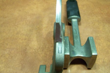

I stole the idea for the fin from the Geco website,the sandwiched design,and machined a grove in the stock Caliper Carrier. I off set it .175" to keep it a little closer to the Rotor. I used a rotary table on a Bridgeport mill to cut the profile but, you could probably cut it out on a bandsaw if you wanted to build your own.
