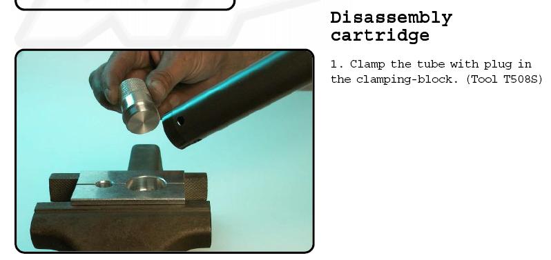

The manual says to pull the spring down and use a # 20 spanner. I don't have a 20mm so I tried a 13/16" (20.64 mm) but it was too thick so I ground it down. Wrong size. :mad:
I'm guessing it takes a 21mm ? I'll buy one tomorrow. I assume I'll have to grind that one thinner too. If that doesn't do it I'll be grinding down my adjustable wrench. lol
Any suggestions to get the job done without buying this tool ?
I almost tried it by just running a rod through the holes but thought I'd ask for permission from you guys before I damage it. :D
STOP!!!!
Never do that!! You will ruin the cartridge.
On a WP cartridge, the spring guide can be unscrewed from the damper rod and the damper rod assembly drops out the bottom of the cartridge. The rebound/midvalve stacks can be serviced without removing the rebound tap from the damper rod.The one thing the WP fork has going for it is its ease of service.
Get the right size tools and read the manual, forks are eaisly damaged by ghetto methods.
Using the cap and spring guide as a jam nut worked great.

Using the cap and spring guide as a jam nut worked great. Everything's apart (on 1 leg) except the screwsleeve/DU-bush.
I still don't understand where the confusion came from? Once the cap and spring is removed you dump the oil, hold the cartridge rod without scratching it, soft vise jaws are nice, and remove the spring guide? Then the rod will drop out the bottom (base-valve end) of the cartridge...
