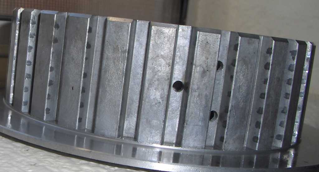

The basket didn't have horrific peening, but there was some. Not nearly has bad as on my KDX. I lightly filed it down.
What was somewhat alarming to me was the outside edge of the basket fingers which was independent of the peening. They had some pronounced edges to me -- something like a serrated butter knife. Like a bad sand casting. The inside edge was smooth and round. I filed the outside edge to get rid of the grabbies.

GGs have the most durable clutches out there. Bucksnbikes just put a basket in my old '00 last year, and my '03 still has the original. The baskets are hard anodized, they will show some light marks on the fingers but not notch excessively. If someone before you had the bright idea of filing the basket to make it "perfect", then its history, because the anodizing was filed off and now the plates are riding on a soft aluminum surface.

I wouldn't say the basket is notched. I had some discoloration where some light peening had begun. I'm not concerned.
The issue with the basket was the outside edge of the fingers that felt rough to me, like it could grab, whereas the inside edge of the finger was nice and smooth.

There was no evidence of previous filing of the basket. I'm not concerned about it. I could just get the new clutch kit and bolt it together.

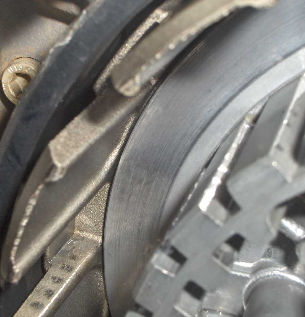

Here's a macro pic of the clutch fingers...
That looks fine. If the plates and springs are OK then start looking at the master/slave for a leak that allows pressure to bleed off, reducing travel and increasing drag. Bleed first of course.
