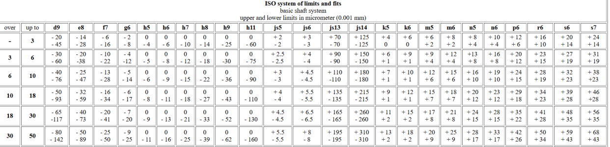

I managed to remove my engine today and get the bloody fly wheel nut off (with an impact driver and heat), I found the crank had a rough noise when rotating. I split the cases to find corrosion on the 28/68 C3 bearings,
My question today is what is the limits and fit for a EC 200 2003 Crank Main Bearing Journal? I believe the bearing outer is a snug fit in the Case, is the Inner Race a G6 or H5 fit ?
I need to see if my Crank Journals are in spec
I've attached a Limits and Fit chart
Thanks
Wade
