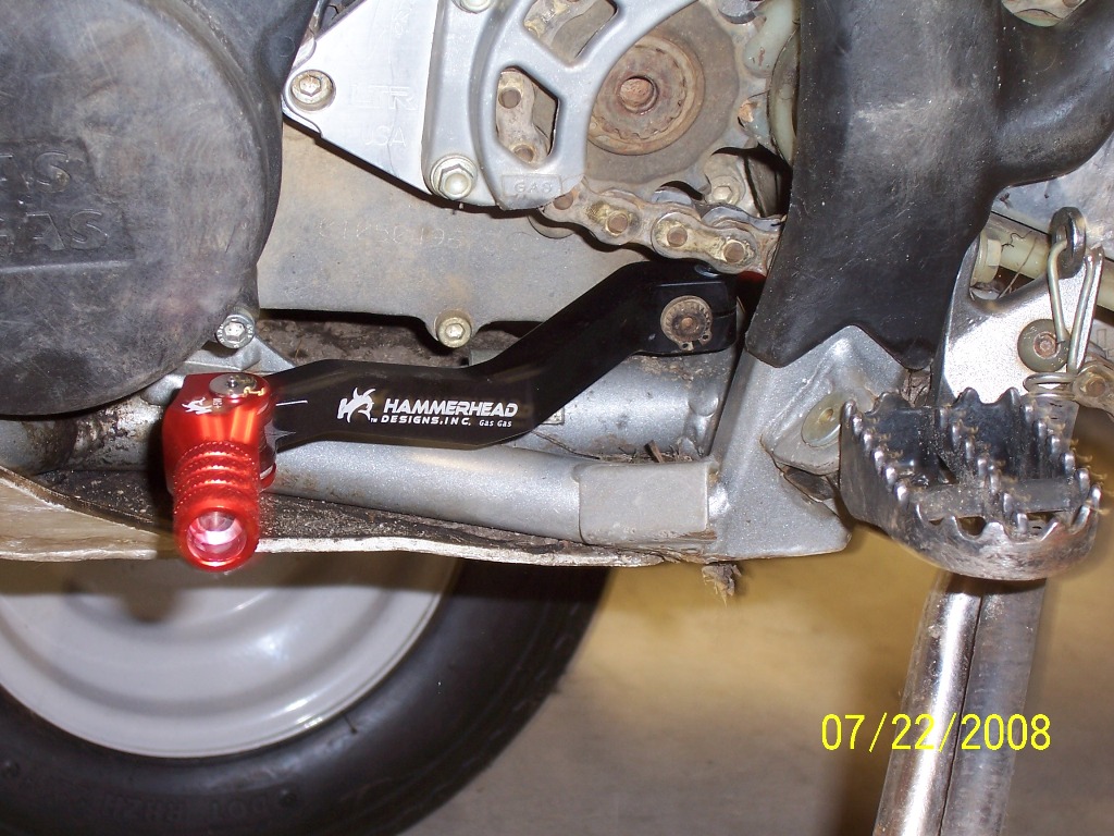

I kept 1 in my pack just in case and when I want to use it the dame thing came with a alien key bolt wtf cant get to it in any way to tighten it up and you cant just use any bolt lucky I was in my shop and could grind the threads off a 8 mm bolt to put it on I see they have right bolt in this Pic thats not what I got

I have the same issue. Pisses me off. I sent them an email about it and never even heard back. :mad:
I just made a few custom bolts with the threads cut off in the center. Took a few minutes and works fine. Faster than bitchin' to them about it, which I'm sure they have heard by now.
Unfortunately it doesn't solve the biggest problem for me, which is wear of the tip pivot and a subsequent sloppy shifter. You can make it as pretty and beefy looking as you want but its still aluminum and will wear fast in muddy conditions. Mine is a only a couple months old and developing play already. I figured this would happen but needed something quick and there was no alternative. I want a shifter with a STEEL pivot, or a design where the bearing surfaces can be replaced. My bro's Husky 250 is still running the same steel shifter for over eight years!
True, but they should have offered to send the correct bolt to me.

I have the shifter and I put a reduced head (8mm) bolt in place of the allen with no issues to date and I've been running it over a year now
