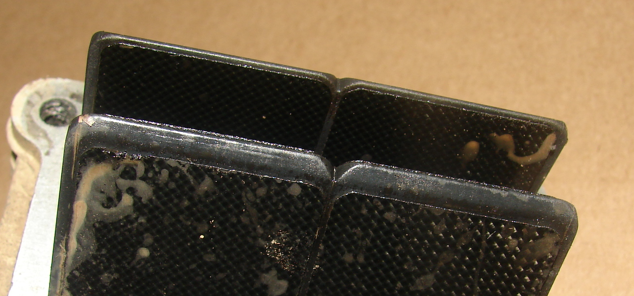

bad reeds
I had the same symptoms with my DE300 plus hard to start and poor idle. Long story short, it ended up being chipped reeds. The chips were on the underside in the centers of both reeds. Bike runs great again.
i really really wanted it to be reeds. i did. but it aint. 2 very very minor chip, not enough to be the problem i think.. now i'm stumped.
