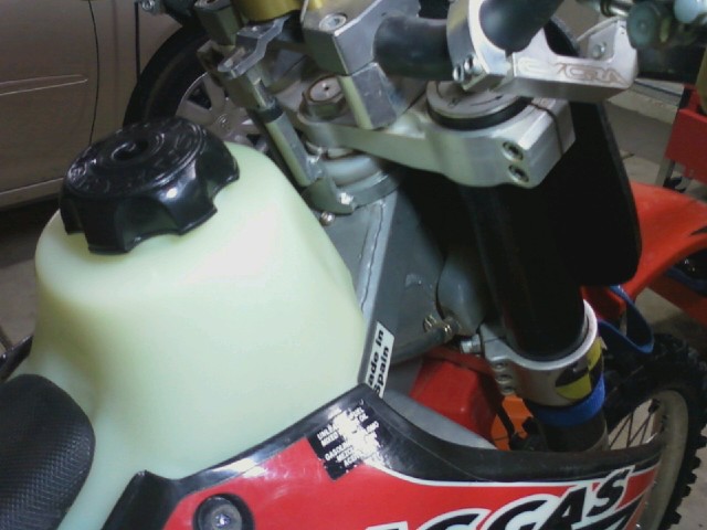

I'm doing some pre-race wrenching and decided to plop on the new tank to see how it fits. It dropped down a bit easier than the stocker. I'm not sure where it gets the extra 0.7gal capacity, but I'll take Clarke's word for it.

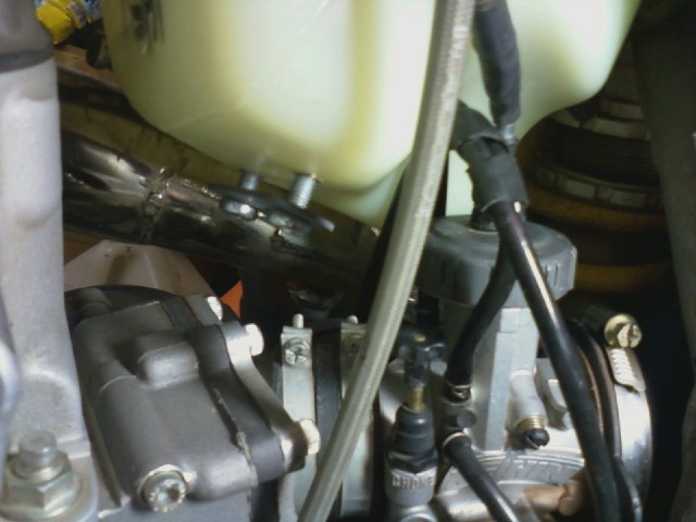

One problem has arisen due to the Scotts damper post. The tank has a flange in front that is designed to fit on the tank breather hole (the other hole is covered by the new tank). The post partially blocks that. I'll likely affix this at an angle and drill & tap a new hole.

View from the bottom left:
View from the top-right:
