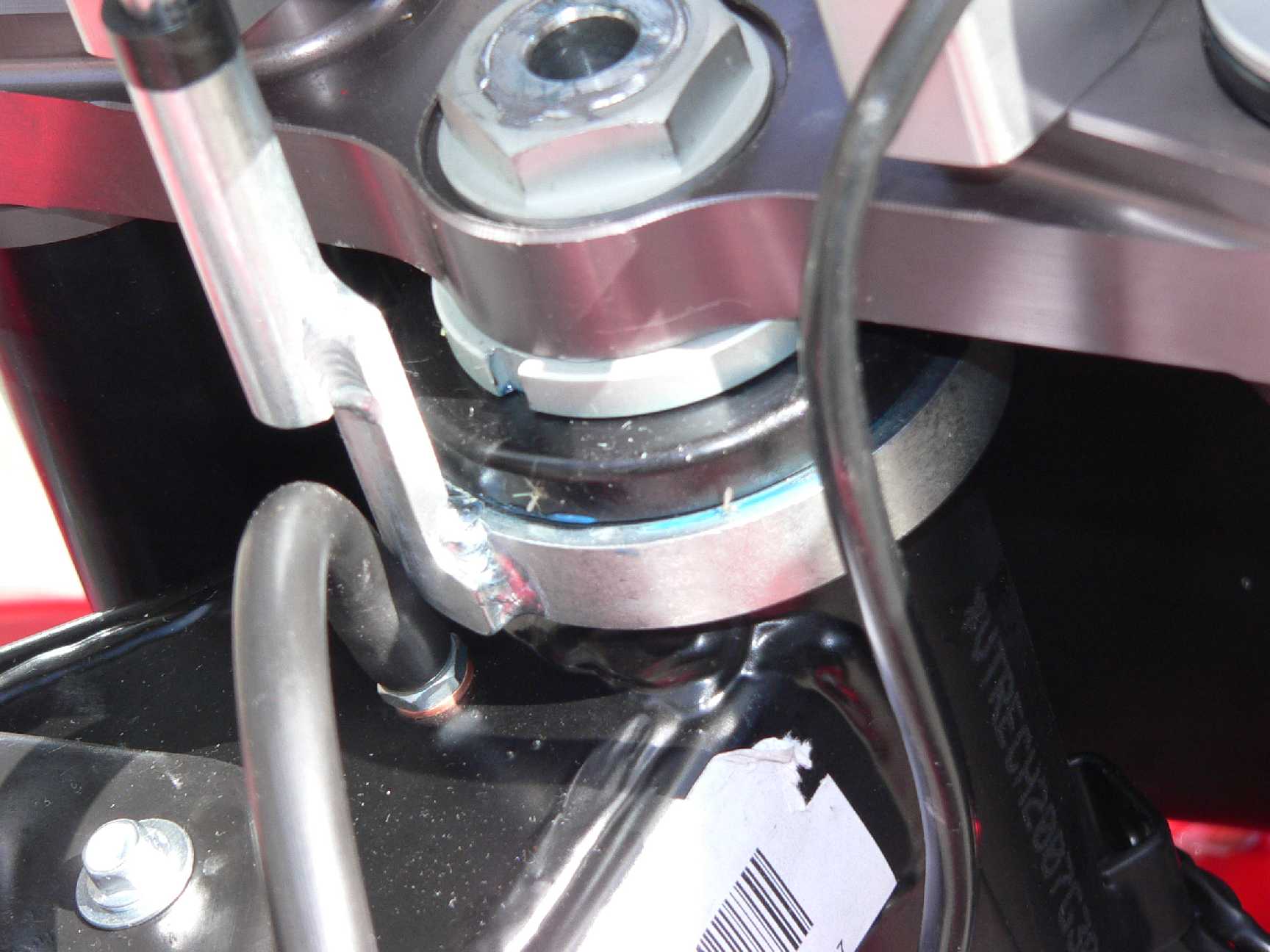

Gas Gas under mount unit.
I'll post pictures when I get it mounted.

I just finished mounting it. The post assembly interferes with the fuel line tap in the frame. A 90 degree elbow would fix it or you can cheat and use a longer line tied by the radiator. I think that's what I will do.How much are they going for? I want a sub mount for my Scotts, might just sell the Scotts & get one of these.

The Scotts/BRP tower kit comes with a nice steel cap thats shorter, so you don't have to cut the plastic one. What works well is adding an o-ring, with an OD the same as the cap ID and about 2mm thick. This seals real well and keeps everything out. My tower just barely clears the fitting. I use a stubby cap vent and plumb the trans/PV vent line to the frame fitting.
I ordered the Scott's cap yesterday. I'll take a couple of rings. It will save me some time looking for them.Yeah and if anybody needs one of those O-rings GMP is talking about I have about 100 of them in the garage that I had made when I put the metal cap on my 04.
What frame fitting?FYI, the trans and PV vent through the same line. Hooking it to the frame fitting makes it just about as water/dust proof as you can get.
What frame fitting?
Actually I wasn't kidding. Why in the world run the PV and trans line to that?Kidding right? The one that your gas cap came vented through that your GPR tower interferes with.

The Scotts tower will allow use of the frame fitting, if that matters. Something to think about if one shows up here or on ebay in the future.
