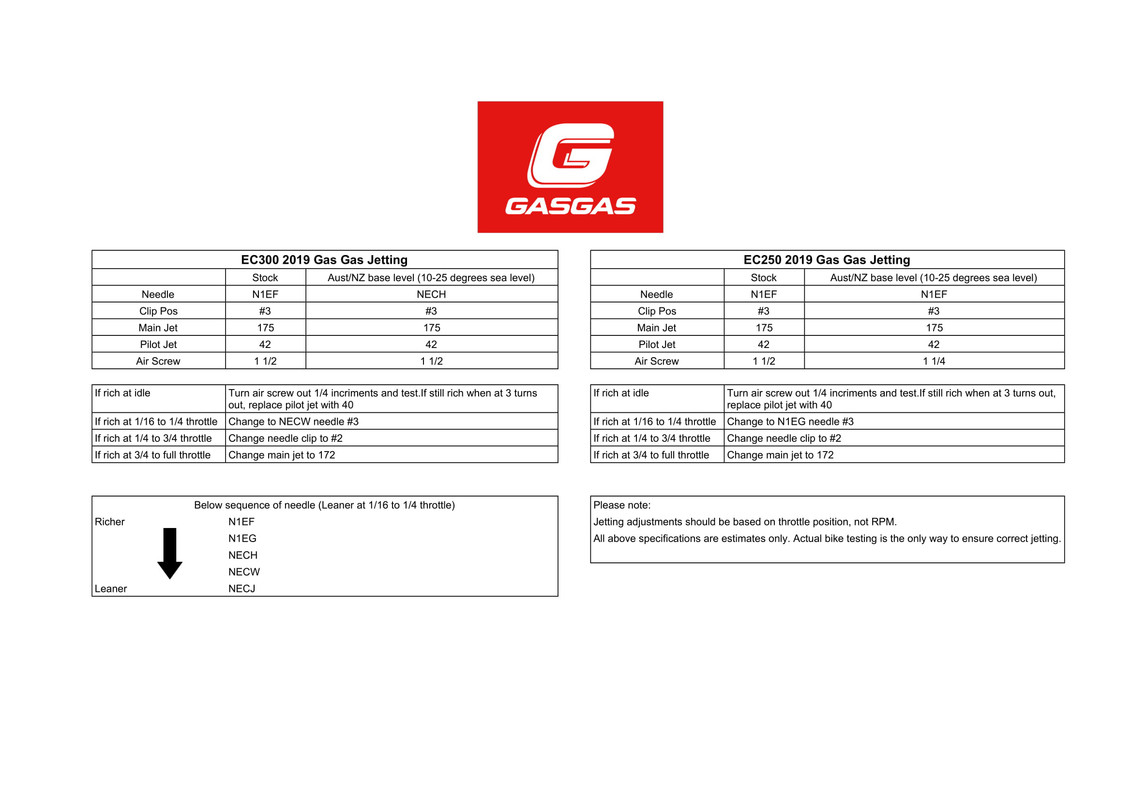

Not sure if this has been posted or is any help to you folk in Oz or NZ, maybe helpful to others that are in a similar situation as us.
