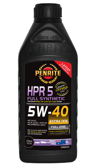

The full syn 10W-40 is currently on sale for less than $40 for 6L.
I have just tried this as well.It's Australian made but seems to work!
Gasser clutches can be sensitive to different oils but no problems so far.
out of curiosity, why didn't you go with the MC-GO gear oil from Penrite?
ok, but my understanding is the synthetic part is of greater benefit to the engine lubing part of the oil (ie in a 4t) and can cause drag on the wet clutch. Anyway i will give the MC-Go a bash in my trials bike and give some feedbackI wanted synthetic, I also like Penrite's write up about their oil. I use a similar oil in my roadbikes and I like the performance/feel.
