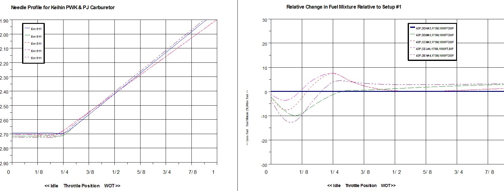

ordered 4 needles today.
ccm,ddm, cel, and den. they are all very similar to ddk after 3/8 throttle. they all should idle in hot weather (cel may not), they just have slight rich/lean adjustments at 1/8 - 1/4 throttle...
we will see what happens..

the problem i found with tapers is there's a big jump from 1.45(D) to 2.00(E) degree tapers - i don't think anyone is running e series needles....right? i could go with a shorter needle to achieve similar effect - but shorter needle affects earlier in throttle position right?? i'm gonna experiment with the strange needles (like DEN) and see what happens..
DDM #3, 45, 2.5, 175 main gets me very nice idle, and very smooth power delivery. no lean spots like the jd red. i like the jd red for the hit, but the ddm is so predictable and smooth. now if i could just get a little bit more outta the mid like the jd red had, that would be nice. i'm not sure which needle would have another taper so i get a little more juice out of the mid - the ddk/ddm are basically the same - and have a nice feel, but it would be nice if they didn't feel flat at the mid/top - don't get me wrong - the power deliver is electric smooth, which is great for the woods, but i'd love to have a small hit at 1/2-3/4 throttle...so i can loft the front wheel at speed and clear ditches/logs, without shifting/changing up.
i will play with den/ccm/cel when i get a chance.
