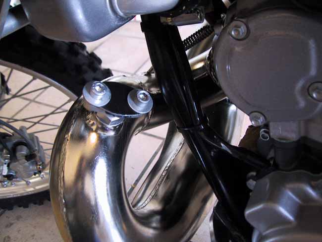

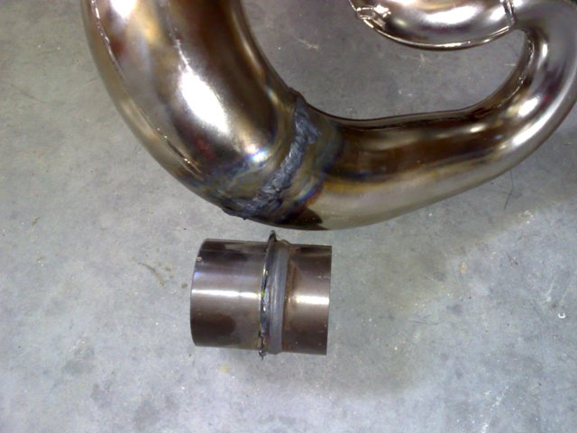

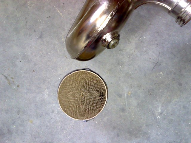

One possible problem area: The stock silvery pipe was finally smashed up and I couldn't fix it because of the heavy gauge. The bike was street legal and had a black pipe with an extra air pipe close to the cylinder. I had the pipe removed and welded shut. I'm now using that pipe. I assume it is otherwise identical to stock. Possibly, it's not and is more like the Gnarly with good bottom but lacking on top, or worse.
